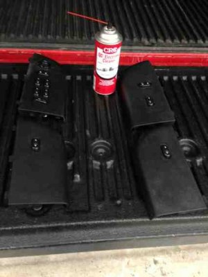

    I swear if you spray the connectors with electronic cleaner they'll work no problem :jester:

  6. Dawgfan54
    Dawgfan54 Full Access Member
    529
    Just sprayed them all and plugged the one in for the back door, with the motor, turned the key for power and it didnt work.
