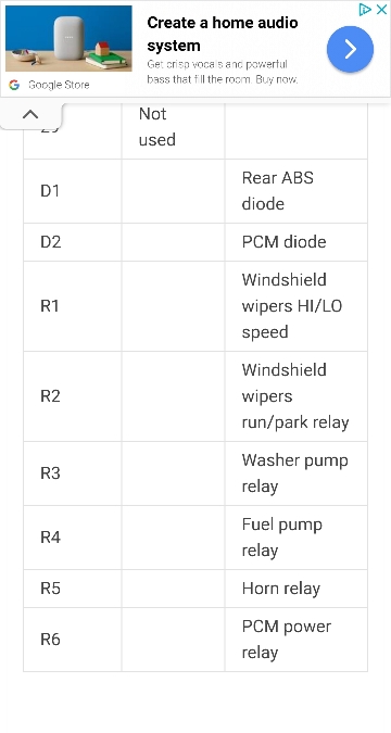

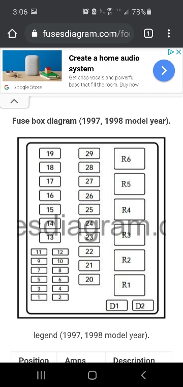

Says 1997-98
But same location on 2002.
R1
R2
R3
Swap out another 'unused' relay for testing purposes.
Use the horn relay R5.
