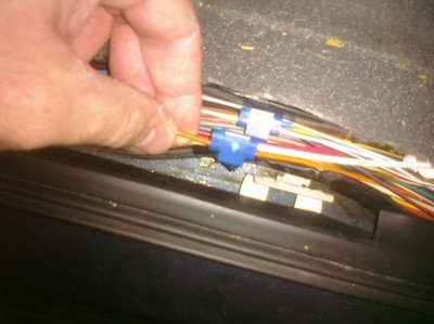

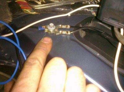

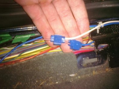

After getting the door trim panel, kick panel by parking break, and door sill off, I started to find the wires needed. What I wanted to do was wire up the puddle lamps to my reverse sensors, this way to aid when I park at night and in garages (those that I can fit in). I knew that the black/pink stripe was reverse since I had spliced it for the LED Light bar. To make things easier, I cut the electrical tape around the bundle and found the wire. Spliced and ran it up towards the parking brake area. I decided to splice it here again and run the wire over to the passenger side as well. Then I found (after several mistakes) the signal for the LED turn signal, green w/ orange stripe. I decided to run these to the rear lights, and they function both as turn signals, hazards, and also illuminate when I hit the brakes. This might not be for most, so again, this is just how I did my truck and feel it helps drivers be more aware of me in traffic. The wire for the passenger mirror is orange w/ green stripe. I found grounds on each side of the lower kick panel where I wanted to run the wires into the door, so just started that there.

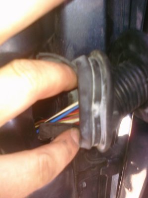

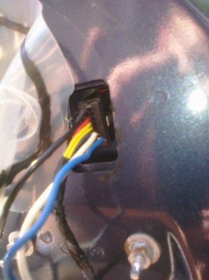

Now to run them up to the door. I found it was easier to bundle them w/ zip ties. Remove the rubber grommet containing the factory harness for locks/mirrors, and run your wires through it. After feeding the wires behind the plastic and up towards the mirror, I wired them based on the diagram found at Tascaparts.com (vendor posting for towing mirrors has this also). All I did was expose 1-2mm of wire on each, and threaded into their respective slots until they were exposed. Then I connected them to the mirror creating a solid connection. Thanks!
