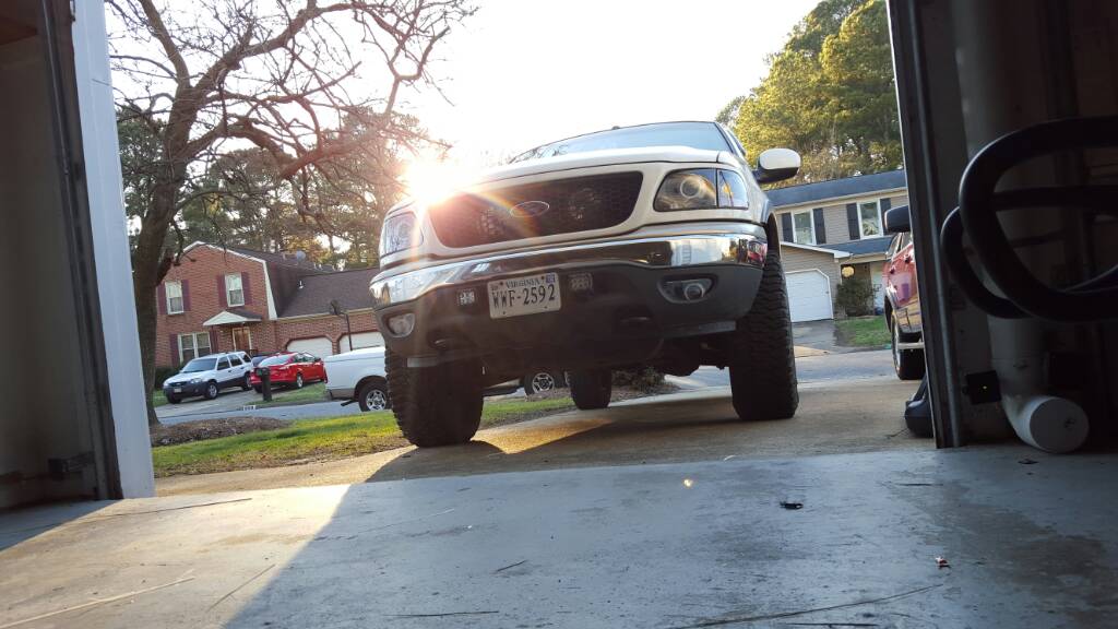

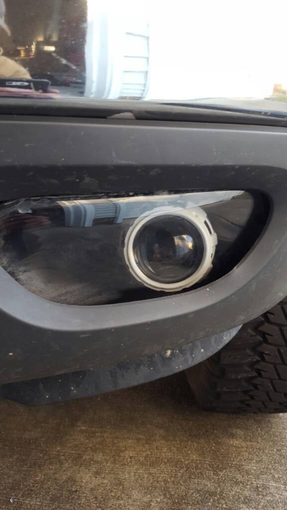

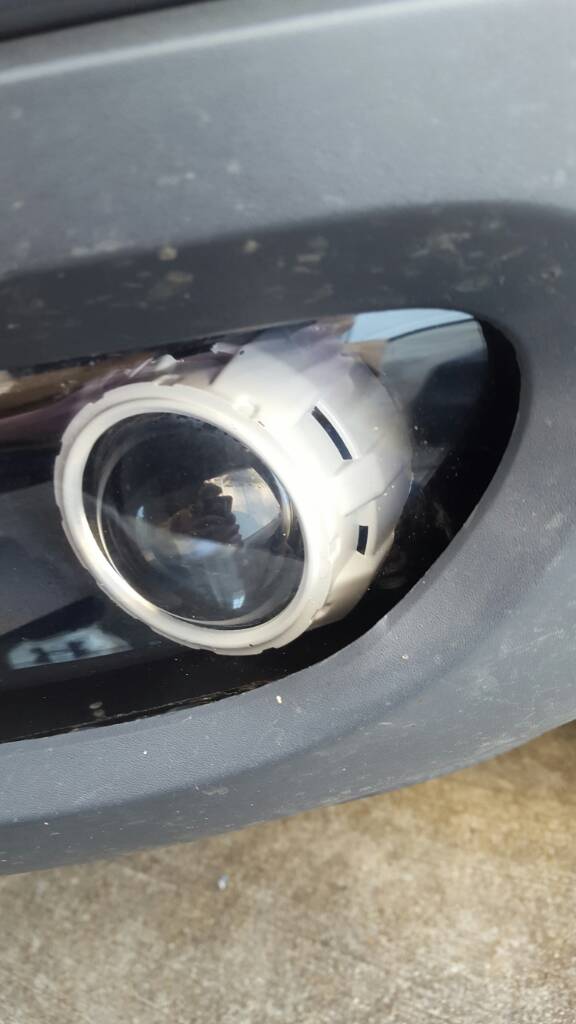

    That's an awesome idea, I probably should have done that lol. I ended up just covering the back of the housings with aluminum tape then covering them in jb weld to seal it. And I didn't even bother to cover my mounting brackets. I just painted them black. They are impossible to see unless you get about 6inches a way from the fog light and look in a just the right angle. I need to add more sealant to my lenses tho. And the output is awesome! These on high beam plus d2s running 55w really makes both sets of offroad lights almost useless lol[​IMG][​IMG][​IMG]

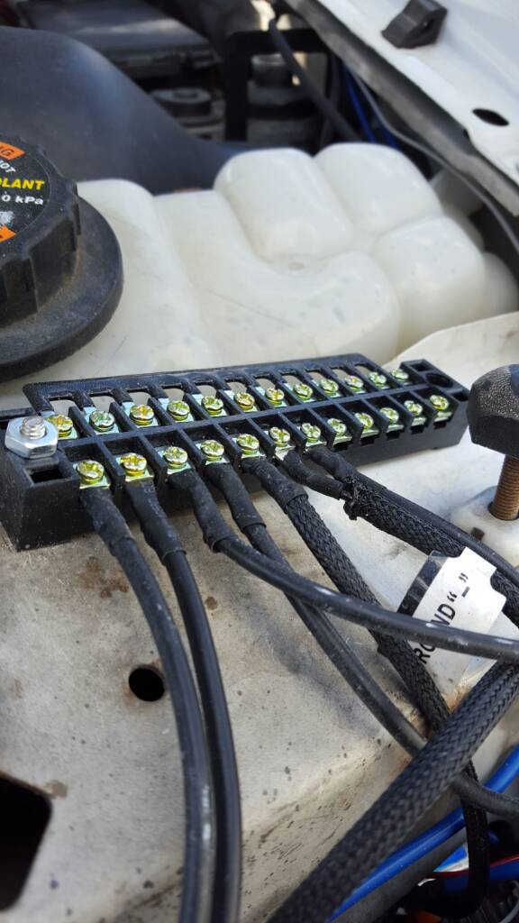

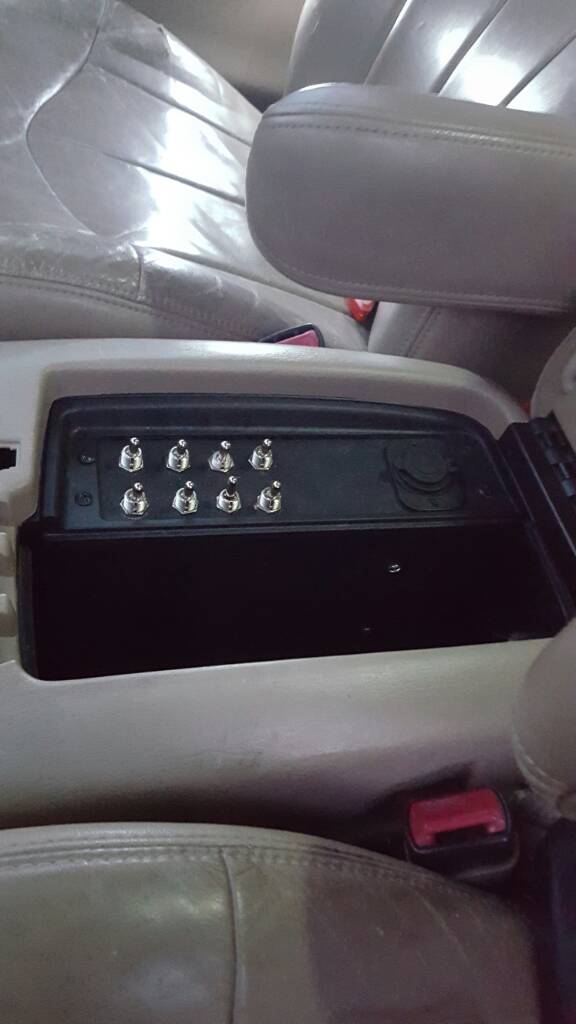

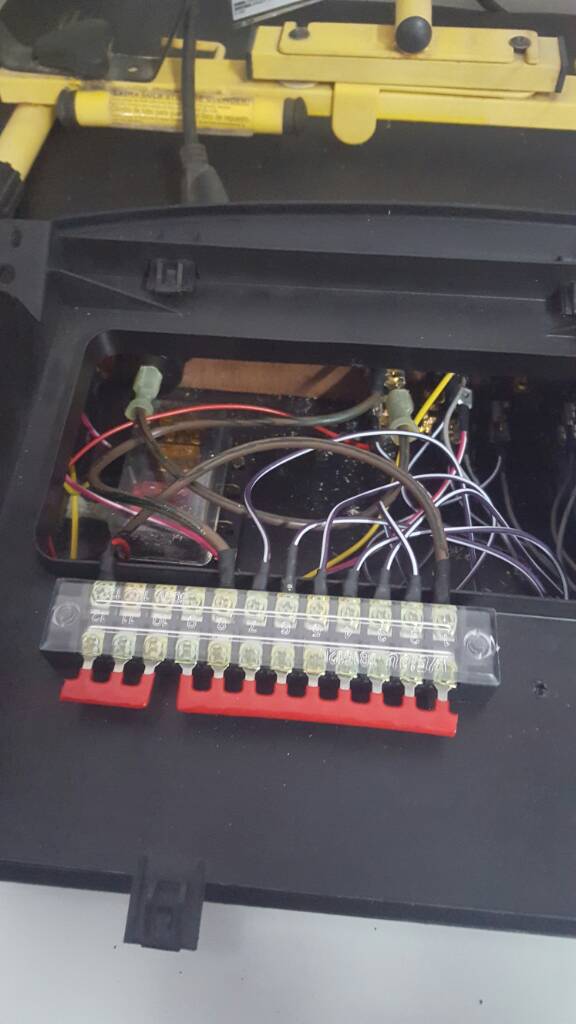

    I ran a few new wires [​IMG][​IMG] Only one of those switches has to do with the fogs tho and it just feeds into the factory circuit so it's not really new. I did ground the ballast to a common point here [​IMG] but my headlights are also grounded there so I don't think that's an issue. Them I ran a wire for the high beam solenoids but that's it.
